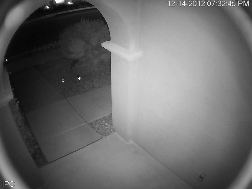

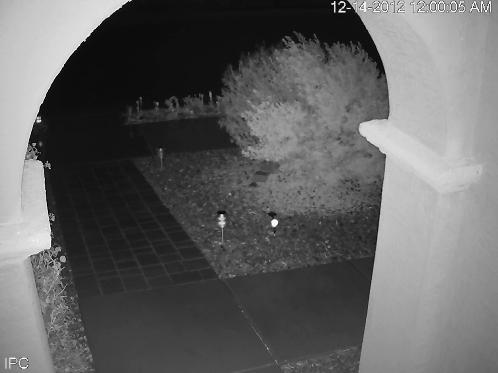

I received the new lenses and installed them today. Here is the review:
The $3.00 lens (3.6mm) leaves a dark ring around the viewing area. I believe this is due to the lens not wanting to focus until I almost had to screw it all the way in. The view is wider, which I do like, but the dark ring is somewhat of annoying factor.
The $14 MegaPixel Lens (PT-03618MP 3.6mm F1.8, Mega Pixel). It gives me the wider shot but there is NO dark ring around the corners like the above lens. The lens focused in at the same spot the factory lens does, unlike the above lens.
Overall the 3.6 mm lens gives the wider shot but at the cost of losing a narrower more upclose shot. Without a doubt the $14 lens is the better lens if you want a wider shot without the dark ring around the corners.
I will try and take screen shots and post the before and after.

I am having a hard time getting a screen shot. I can download video but it requires the special codec to play it.
Any quick guide on how to grab a screen shot/pic off of the NVR?
Are you trying to do it from the computer or from the nvr itself? PSS has a snapshot feature, just tell it where you want the pictures to be saved to.
Above is the factory 6mm lens. As you can see, no dark ring around the corners.
Here is the 3.6mm lens for $3.00. It creates a dark ring around the corners and at night it is worse because of the LED flare. The other 3.6mm MegaPixel lens does NOT create the dark ring.
All-in-all, I think it is better to pay the $14.00 and get the better lens vs. the $3.00 lens. It's just $11.00 more and you don't get the dark ring and flare at night. You get what you paid for...
Wow...that 14 dollar megapixel lens looks good. I wonder if a 6mm lens from the same manufacturer would be an upgrade to the stock 6mm. Thanks for posting the pictures!
great picks jack! the $14 lens looks way better, the other stock lens looked out of focus and colors washed.

Great info and screenshots! The two different 3.6mm lenses are almost certainly 1/4" (with the dark ring) and 1/3", since 3.6mm in the same size would give the same zoom factor, while 3.6mm in different sizes give different zoom factors.
This is due to the light from the lens covering a different area around the sensor. If you took the pic with the dark corners and selected a square that excluded all the dark areas, it should look a lot closer to the 1/3" 3.6mm lens field of view.
In any case, how much quality can you expect from a lens that costs a few dollars?
The $14 lens is clearly the best of the lot, with much better detail even at the wider field of view, and is a pretty small investment for that big a quality increase. It would be interesting to see if the stock lenses are plastic or glass - that factory 6mm image is really not very good. I may try an upgrade on my Dahua with a stock 3.6mm lens - if it gives that big an improvement, it'll be great.
