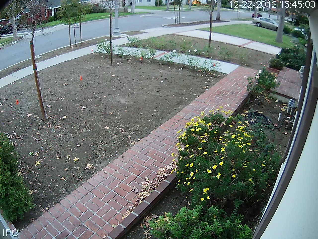

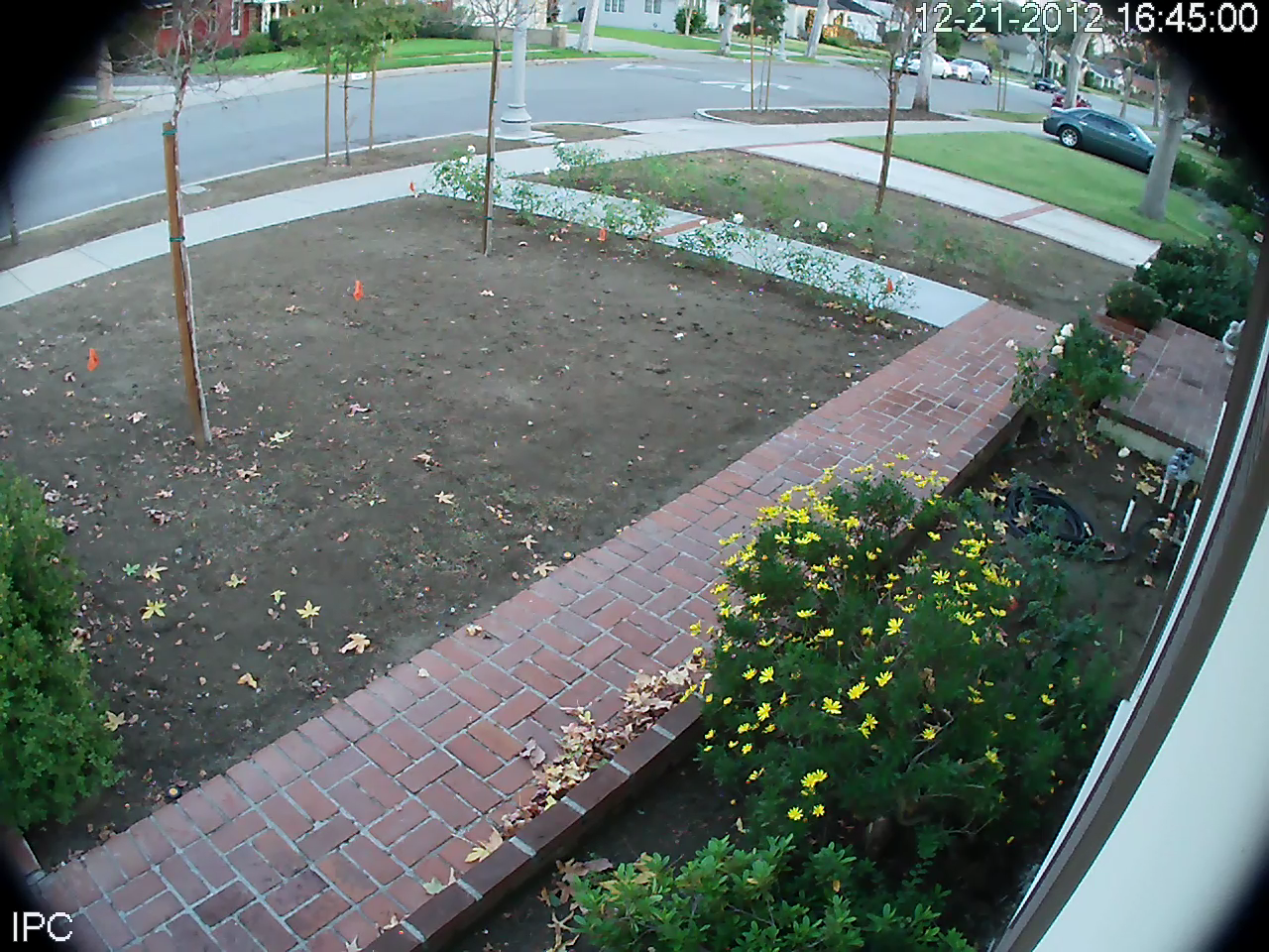

Swapped in a 3.6mm megapixel lens in today. I also waved a magnet at my other camera that wasn't seeing the IR at night time. Well, the magnet got it to work now. I'll post some pictures when I come back from dinner.
Pardon my front yard...Currently in the process of landscaping.
This is the 3.6mm Non MegaPixel lens from DX.
This is the 3.6 MegaPixel lens from M12lenses.
I'm still seeing some of the corners cut off a bit. I'm thinking that I'll also have to go back and re-focus? Some things look more in focus with the non-megapixel lens. What do you guys think? Worth the effort? It's not like you just unscrew the front of the camera off.
Btw, did I export these the correct way? I logged into PSS and searched for the above timestamps. I then took a "snapshot". Is that the best quality out of it? Did I need to do it from the NVR instead?
