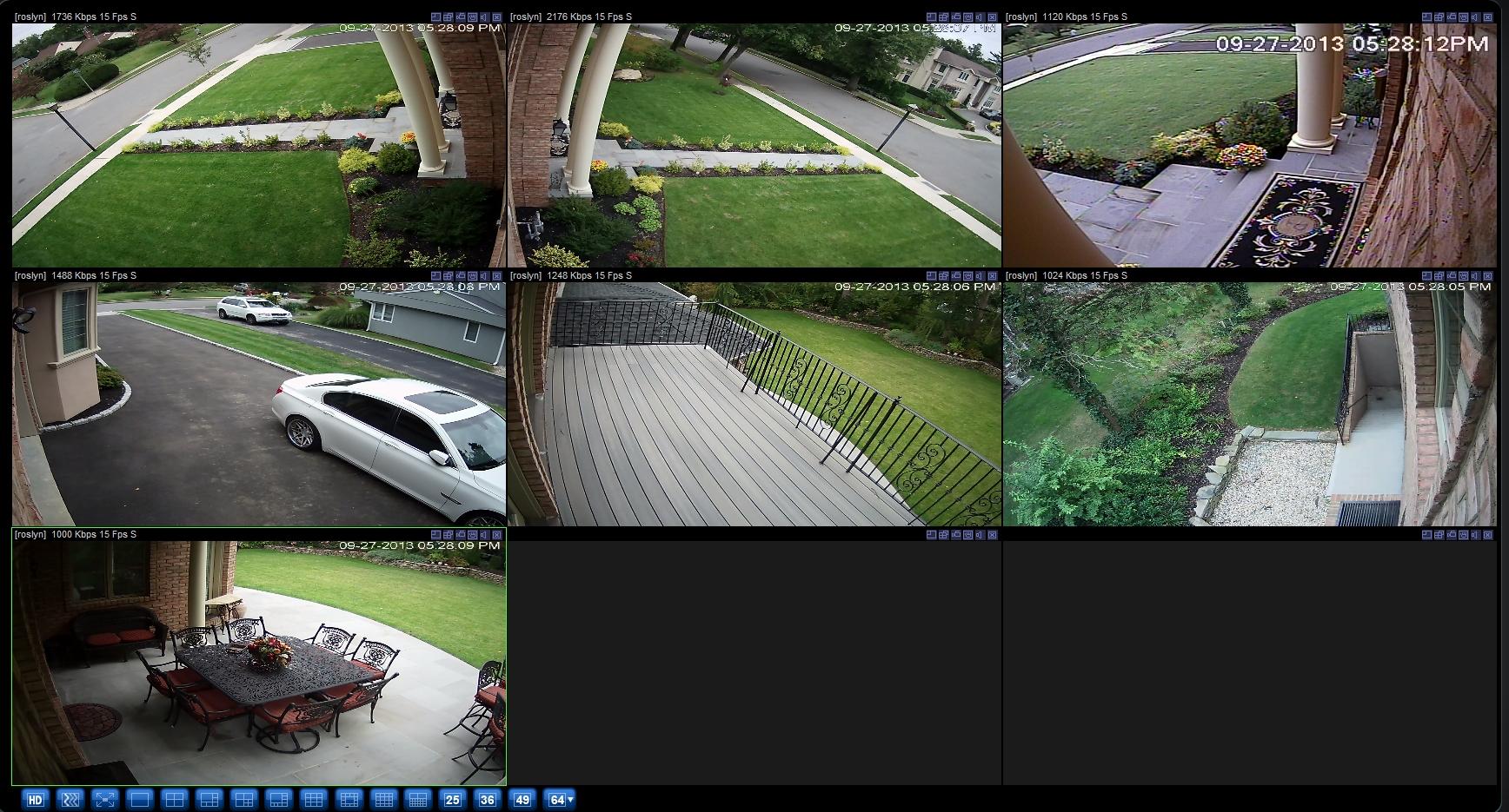

I just finished up this job today and we used an analog camera for one of the cameras for our reasons. I used a DVR as an encoder and put the camera on the NVR. Can you guess which one is the analog? If you win, you get to pat yourself on the back!
# 3 sucks
means Analog
The reason I used analog for the front door was I split the analog video out of the camera. I installed a 9" LCD screen inside of
the house so he didn't have to drill a peep hole on his very expensive doors. So, the analog camera feeds the LCD screen and than comes down to the basement to the DVR. The DVR does not have a hard drive cause I'm using the NVR to record it.
