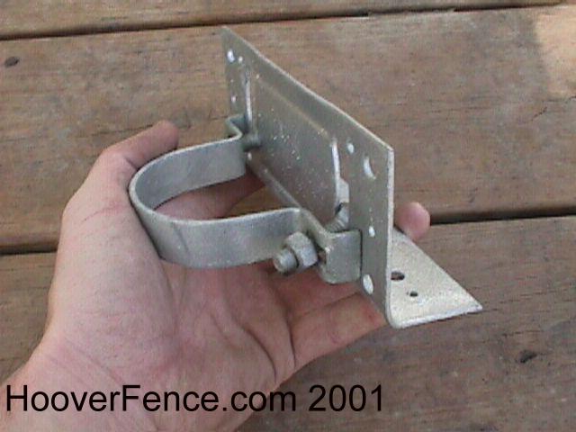

Q2U 0 Posted February 13, 2014 How about something like this? Mount a piece of CCA or plastic 2x6 to it and mount your camera to the 2x6. I purchased one at Home Depot store for $4.75 but I haven't tried using it as a camera mount yet... Or this for $2.37... http://www.homedepot.com/p/Oz-Post-Steel-2-Wood-Fence-Bracket-WAP-OZ-50110/204675163 Share this post Link to post Share on other sites

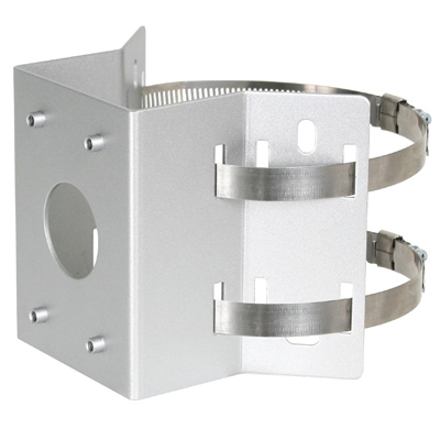

mgb 0 Posted July 30, 2014 Here's a universal pole mount by STI http://m.sti-usa.com/mobile/Products/Universal-Pole-Mount-Bracket-for-CCTVs-STI-7081.htm Share this post Link to post Share on other sites
