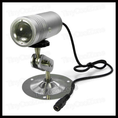

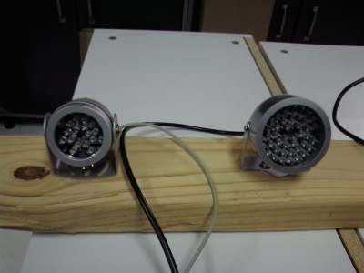

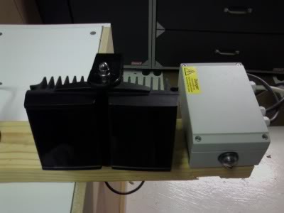

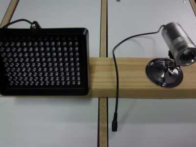

I was surfing Ebay one day, and my curiosity got the better of me. They have a number of LED IR illuminators for sale there, and I wondered if any of them were a bargain (you can easily spend $1000+ on a high-end illuminator!) I ordered a handful of them, along with a couple from US-based super-circuits, to see how well they would work.
First two:
Link to supercircuits (model on left)
Link to Ebay (model on right)
Second two:
Link to Ebay (model on left)
Last one:
Link to RayLED (british company)

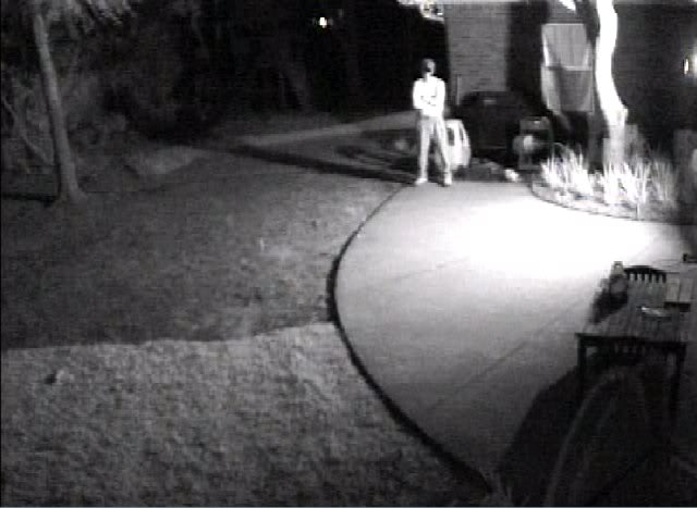

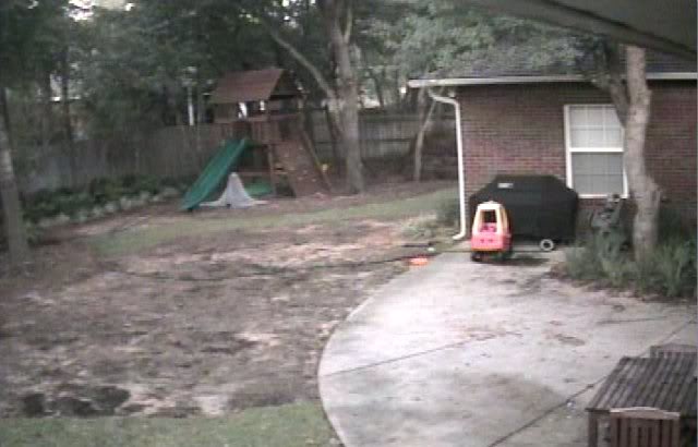

Here is the scene where these lights will be tested. This is a daytime view, through a 420TVL day-night armored dome camera. This particular camera has built-in IR that is advertised to go 100 feet. However, as you're going to see with the camera and most of these IR sources, their "estimates" of range are wildly optimistic. You can pretty much cut the advertised range in half right off the top. The distance to the corner you can see in the picture is about 40 feet, and the illuminators will be tested by being mounted about 20 feet away, just off-camera along the right-hand wall, roughly focused on the same spot perpendicular to the camera's view. If that doesn't make sense, it will as soon as you see the pictures
Daytime view:

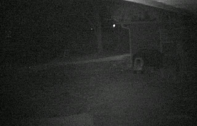

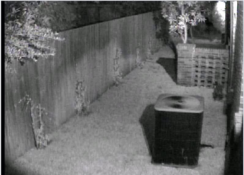

Night time view (with only the built-in camera IR operating). Ignore the IR light you can see coming from around the corner... that's another IR source and another camera. We're mostly concerned with the area between this camera, and the corner:

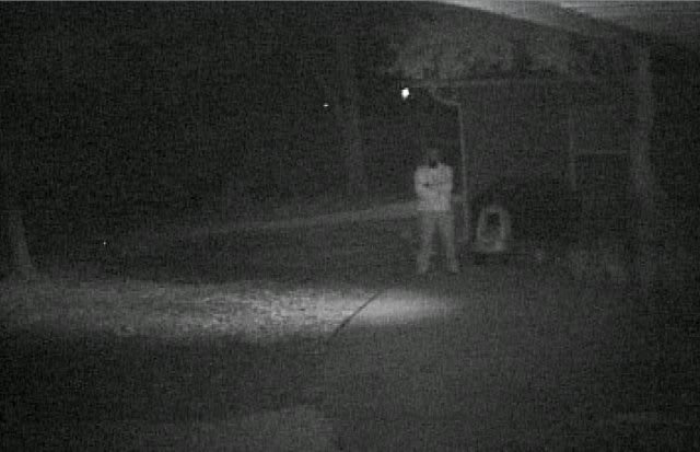

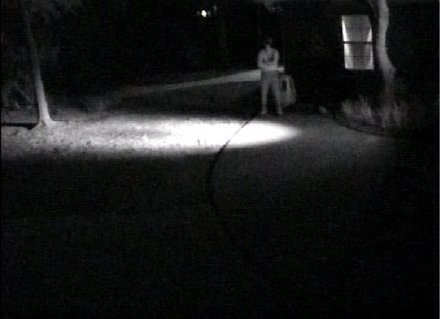

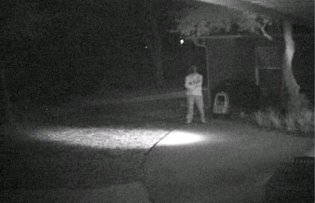

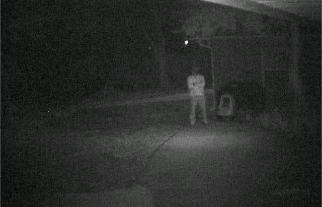

First, the super-circuits model. As you can see, it throws a dim pool of IR light, with a fair amount of dispersion. In contrast to what you're going to see from some of the other illuminators, it's more of a flood light than a spot-light. You can barely see me standing at the edge of the illuminated area. I will be standing in exactly the same spot for all of these pictures.

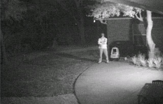

Second, we see the round, puck-like, 40-LED Ebay model. Compared to the super-circuits model, it's brighter, and the beam is tighter. It also gets quite a bit hotter when operating.

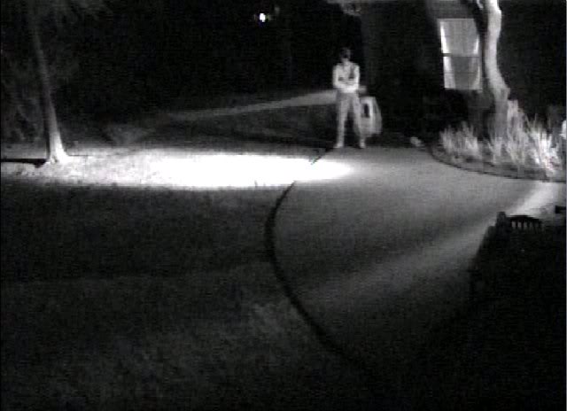

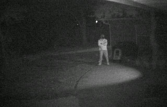

Third, we hook up the square floodlight-appearing Ebay model with 140 LEDs. This one's the brightest of the lot so far (as you might expect with the higher number of LEDs). It also has a cooling fan inside that whirs audibly when powered up. However, there is no visible vent area for the hot air to escape the case, leading me to doubt the effectiveness of the cooling fan. The included power supply also died within an hour of being hooked up.
Fourth, we connect the tubular round-lensed model. This one seems to be a much higher-quality unit, and also gives one the ability to focus the IR beam by adjustments to the lens. It provides very even illumination, without hot-spots, though it's a little dim compared to some of the other lights.
Last, we hooked up the RayMax50. This industrial-strength thing puts out some serious IR light, and adjusts from a 120 degree beam angle to 180 degrees (you're seeing the 120-degree setting in this picture). The angle adjustment allows one to illuminate the entire side of a structure with a single device, if desired. This all comes at a steep price, of course; almost ten times the cost of some of the other units:
I can't say anything about long-term reliability with any of these units, but they all do seem to work as advertised, with the aforementioned caveat about the limitations of their stated range. Even the RayMax doesn't seem to reach out quite as far as company literature claims.
I should point out that ANY of these illuminators would be sufficient for a person wearing a proper set of NODs. I tested all of these illuminators with gen2 and gen3 NVGs and found that even the cheapest illuminator (or simply the camera's built-in IR) literally turned night into day. It may be hard to appreciate in these pictures, but the entire area we're viewing is pitch-dark to the naked eye... positively stygian... but wire up a couple of these illuminators and don a set of NVGs, and it literally turns it into daylight with even second-gen goggles.
Hope this information helps somebody.

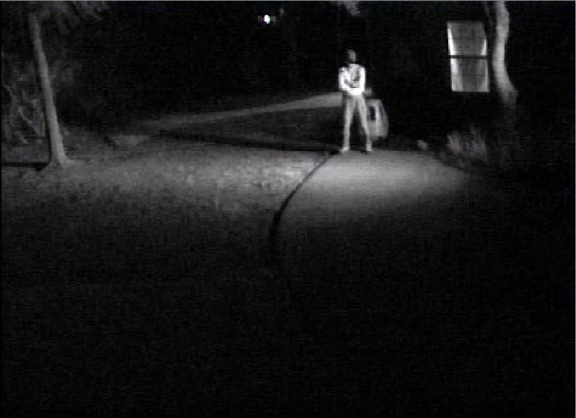

Second set of pictures, taken with the same illuminators, in the same order, only these are from a WDR panasonic dome.

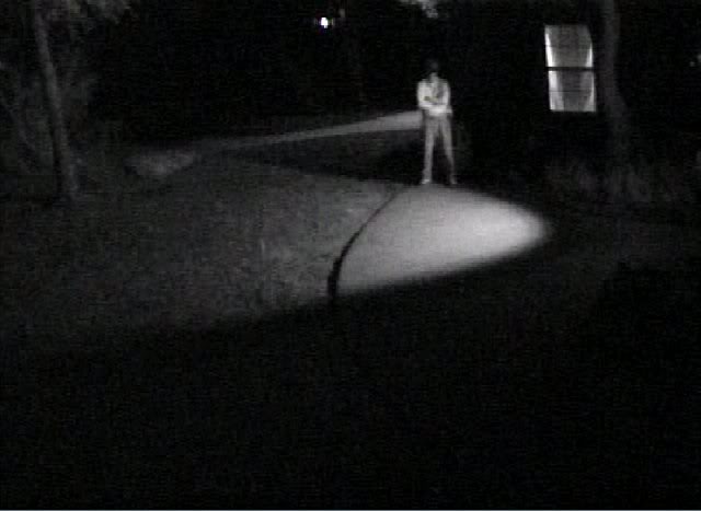

It can work... for example, here is an image from the side of my home, courtesy of a WDR panasonic dome. It's likewise pitch-black at night, but is IR-illuminated by one of the tubular Ebay lensed illuminators (providing most of the lighting, and quite evenly too), with a little help from one of the supercircuits puck illuminators (provides the spot of IR light you see on the tree in the far end of the view).

In your daylight photograph I see that you have many trees in the yard. I will assume that you have a large "canopy" over the area.
Would you be kind enough to point one of the stronger "spotlight" illuminator on in to the canopy? I am thinking that the canopy will diffuse the spot, and bounce the IR back down. I believe this would actually benefit the video shot.
On a second shot I would have you point the spot upwards, and then take one of the "weaker" IR illuminators, and point as you allready have, and then with the two I think you would have a "perfect" IR illuminated video shot.
Would you be kind enough to post those pictures?
Also:
Another reason that I like your photos is that I try to teach my customers that it is just like a photographer setting up for a photo shoot. They always have those "silver umbrellas", and they bounce their flash off of these umbrellas, and then they hold a flash with one hand to the side away from the camera towards the subject.
In your pictures I can see the hotspot from the brightest illuminator, and I can see the fade of the weaker illuminator, and I also can see the the illumination is not even throught out the illumination area. You can see a "cold spot" with in the area of illumination on the ground.
It reminds me of cheap flashlights when you point them at a wall, and you see the direct light from the bulb is weak, but the light bouncing from the mirror behind the bulb has a stronger illumination, or the bulb size creates a shadow within the illuminated area.
What do you think?

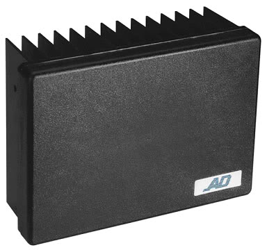

Howver, some do not, even some of the higher-end models. I have a couple of American Dynamics illuminators (AD1020 series). I don't think they're making them anymore, but they have great performance, and run off of 12V (actually 13.3V, but we're not splitting hairs here)
Unless you buy the PSU to go with it (they're quite expensive... to the tune of about $700 each), you have to wire up your own photocell.
