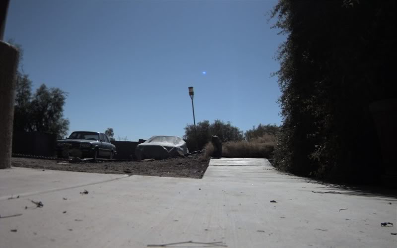

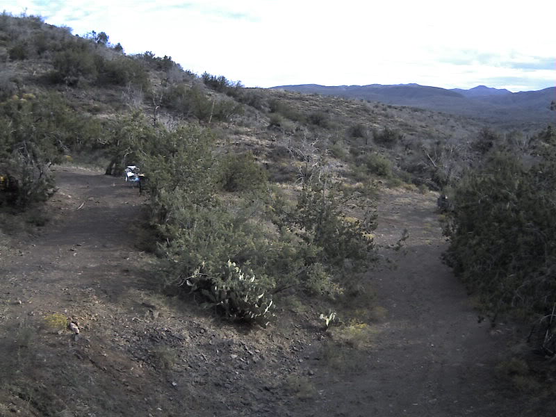

So I decided to pick up a couple of NIB AR5105DN's. Figured 2MP to 5MP I should be blown away, right? Forget it, real disappointment! The resolution is not at all what the YouTube videos show or info I've seen. Here's some of the "Save as picture" grabs off my screen. They looked the same way in real life. Resolution at Full or Half and JPEG quality at 21, even fiddled with the Web Browser interface which is where the pics came from. What am I doing something wrong or is this crappy color resolution what I can expect. I've seen as good pics off old Costar CCD2500HX PTZ'z. And thanks to this forum I now know what that allen wrench is for, no instructions in the box.
Any help is appreciated because I might be stuck with these. BTW if I look inside where the lens screws in the board says AV5100, but firmware says AV5105.
AV5105 Half Resolution JPEG quality 21
AV5105 Full Resolution JPEG quality 21
AV2100(2006)Full Resolution JPEG quality 21
AV2100 (2006) Half Resolution JPEG quality 21

They are straight off the Web interface in the firmware. I double checked. They didn't seem any better than the AV2100. Double checked on the half/Full Resolution etc. Like I mentioned when you peek inside the front board says AV5100. These are brand new with current firmware. What do you think the problem is. Pics were pulled off the Arecont camera IE interfase by clicking "save as picture" and the saved files looked the same way as live view.
All those pics are only 800x600. 2MP should be around 1920x1080. IE is just saving the picture as it's displayed, not the full-size video frame.

So is my resolution problem one of the Flat panel I'm displaying it on? The computer displays HiRez from the web or Youtube fine. These captures were off a Notebook Computer but the resolution didn't appear any better on a 1080P Flat Panel Computer Monitor. Plus the color appears washed out . 2560 x 1600 is what the below image reads when checking properties, but is reduced when saved as JPG. How do I capture it at full rez for you to look at of the screen? Pic looks the same as far as color and rez in the JPG here.
Lens is the Arecont supplied MPL 4-10 (F1.6/4.5-10mm1/2")
Upload it to its true format. Do not convert it to any other format. Does it save it as an original bitmap file? If so, you can get those hosted for free at photobucket

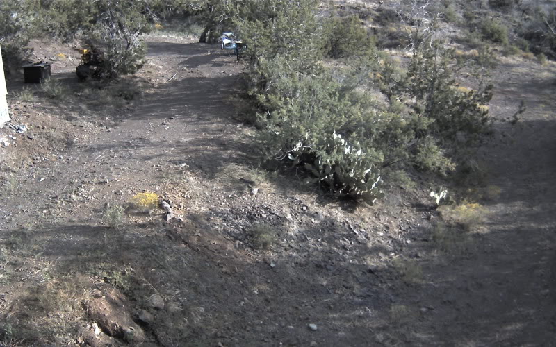

I installed the cameras using the AV100 mini disc. It looks like all it installed was the AV application manager which I used to setup cameras. The actual video setup is only available on the cameras IE interface where you have "About""Image""H.264" etc on the top left bar. This is the way I had it set up before. I've tried saving as a bitmap and now it indicates a11MB file at 2560x1600 (Full Res at 21 JPEG Quality) and 2.92MB at 1280x800 (Half Res at 21 JPEG Quality). Tomorrow I'll set the camera outdoors and save a pic, upload it to Photo bucket so maybe you guys can tell me if it's performing as it should. Really hoping I screwed things up as I can't believe the color depth is so poor and resolution nowhere near what I believe 5MP should be.

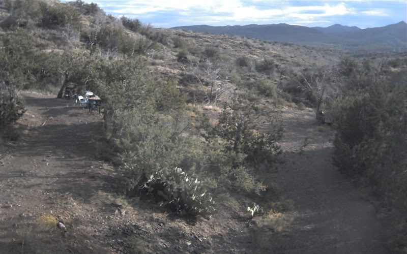

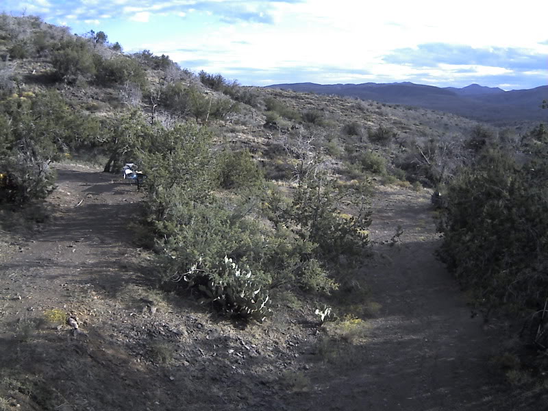

Here's the pics in full resolution as Bmp's on Photobucket. Uploaded a 11MB file to Photobucket but apparently it's saved as a smaller JPG. Still pretty bad.
AV5105DN Full Resolution 21JPEG Quality
AV5105DN Half Resolution 21JPEG Quality
Thats not full resolution bro. If it was full rez, it would be huge and would not fit on the computer screen once you click on it. Actually for a little Jpeg image, it doesnt look that bad.

Possible reasons for the image quality issues...
-- lens not good.
-- iris not adjusted properly for depth of focus (dof looks pretty bad in those images)
-- running Arecont on default image settings (brightness, sharpness, saturation, gamma). Arecont @ default typically looks bland, soft, and dim; need to tune and save to flash in AV100.
It doesnt appear that the image quality is that incredibly bad. The problem is, those pictures are not in full resolution.
