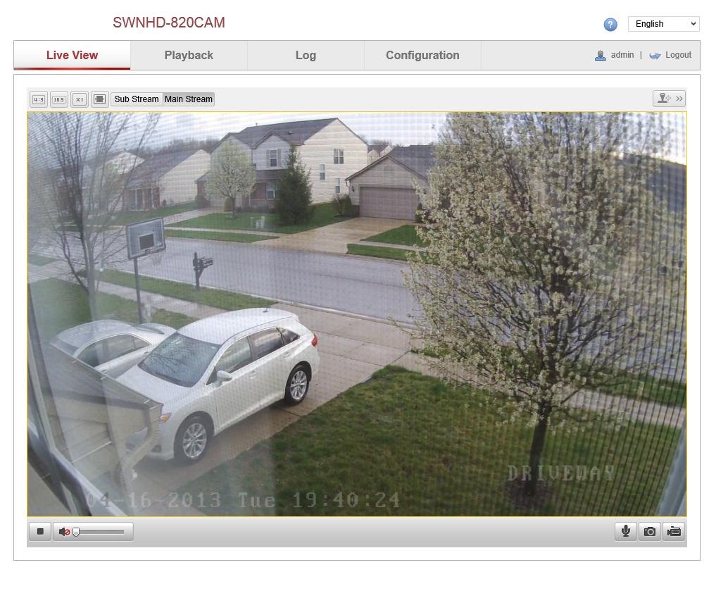

No problem. I'm kinda excited. Are you able to log into the camera with your web browser by entering the camera's IP address in your browser URL bar? Like this: http://192.168.1.202 (or whatever your cam's IP address really is)?
Yup! Although mine was set to static (192.0.0.64) by default, so I would suggest downloading that software for initial config as it goes out and finds the cameras no matter what your network is set up as (I use a 10.0.1.x range).
Within the iVMS, you can change the IP address as well as many other settings.
Here's a screen shot of the browser interface...too rainy to mount it outside today, so this will have to do.
Dude! That is a TERRIBLE image! It appears that one is looking out of a grid!
The sad part is, even through my screen it looks better than my old foscam. LOL
That's amazing that you can get that level of detail on the screens. Usually that's blurred out so close to the camera.
