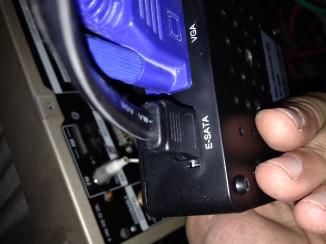

Could you please show a photograph of your ESATA connector?
Hi Eddie.. For storage it's not a matter of speed it's a matter for read/write cycles... Usb sticks are not designed as ssd's or hard disks... This is why the restriction exists... Ports 505x are the streaming for each channel. Now as for resolution if reset to default settings it usually starts at low resolution visible to any monitor or TV. For USB storage power was not enough for me... So I ordered an esata cable and make a Y-split to the 5V adapter... Now my Hdd works rock solid and through a more "physical" interface esata... Thanks

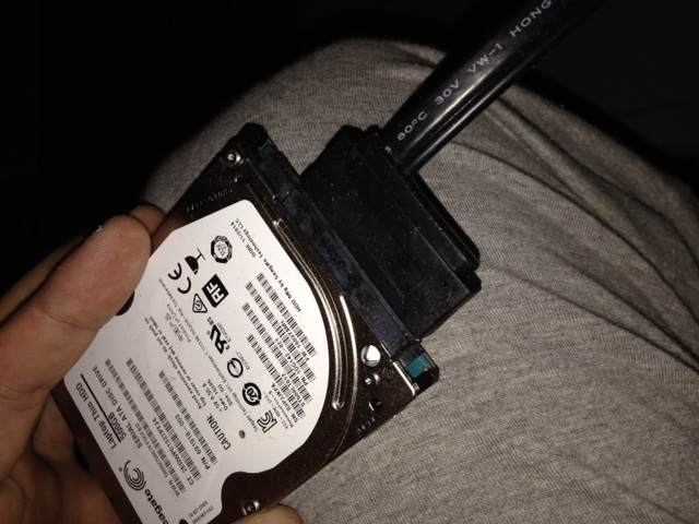

Sure! Here is from the disk side
and here from the NVR..

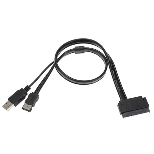

From NVR side it had a USB connector which was for power supply of the disk. I cut this cable and connected DIRECT to the output of 5V 2A dc adapter... Except that is rock solid stable, the disk is working extremely cool...
Here is the cable approx. 3$ from ebay

Thank you, I have that cable but I wasnt too sure how the best way to connect the USB power.
I am having issues with the NVR rebooting, and i think it is something to do with the hardrive spooling up and browning out the NVR.
It's pretty simple... If you cut the usb it has four colors, red,black,green,white. You just connect red & black to the same ones of power supply unit. Green and white are not used... Most of 2.5'' Hdd don't consume more than 500mA...
