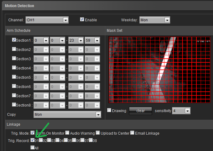

hi im a new in this forum, i already bought escam nvr k108, the problem is motion detection fitur. i login to be administrator and i try to set sensitivity high and drag the zone, the problem is if i confirm the save that parameter, i check again, always back the drag zone is gone and the sensitivity is low, i dont know why. so the motion detection cant work
anybody can help me about this problem?

camera is connected via onvif or i12 protocol?
did you tick record channel number?
yes, I have ticked the record channel. As I said, the main problem is that the motion detection mask disappears the next time I go to the motion detection settings even though I save it.

solution #1)
try connect camer via i12 protocol
solution #2)
set motion detection area on camera (not using mini nvr)

Thank you. The solution #2 works, however it's highly impractical. If the setting is available in the NVR, why should I set it directly through each camera?
When I tried the solution #1, the camera didn't work at all (there was no stream), so I suppose it's not i12 compatible.
However I have not been able to get the email to work. It again works if I set it on the camera itself (send email for motion events), but it doesn't work at all when I set it in the NVR, even though it now catches the motion events, i.e. it records when motion is detected but does not send email (the "email linkage" in motion settings is checked, I assume that should be checked when I want to send email)
Ok, I'm taking back what I said, the motion detection works but after some time it stops working. After I restart the NVR, it works again. The camera is detecting motion all the time (I see it in the camera log) so it's clearly the problem with NVR.
The software in the NVR is piece of ****. The email now also worked for 1 event, then it does not work again, it's acting absolutely unpredictable.
