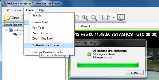

Pay close attention to 11:48 in.
its been posted on the forum more times than seans popcorn.
i ment we all know why. but people buying cheap crap from the likes of ebay dont understand that as well as video other factors need to be thought about

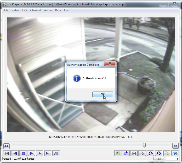

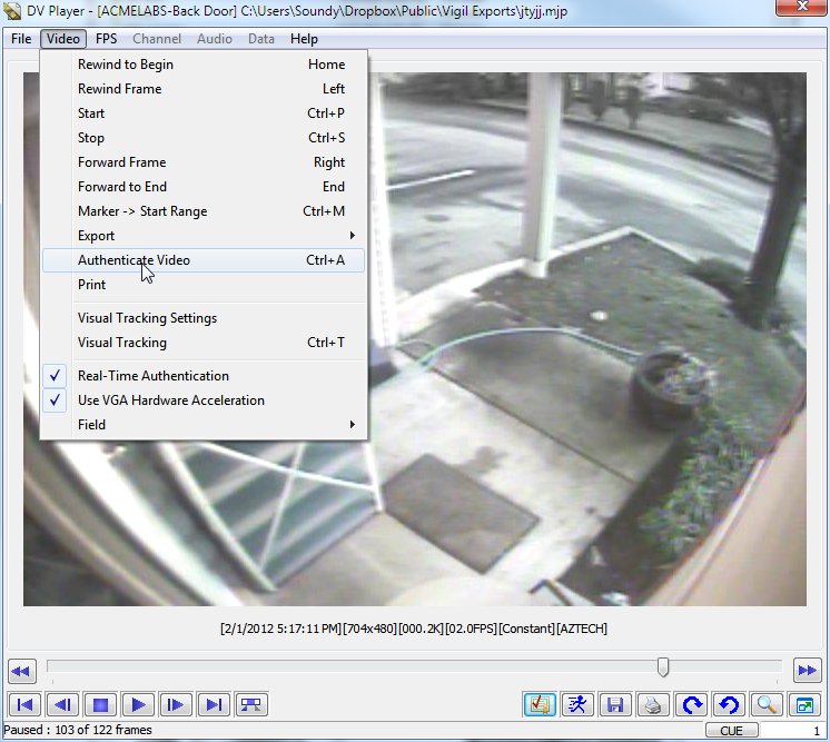

Likewise - I always recommend to our Vigil users to use the native export option ("MJPEG" on older versions, "Authentic Video" on newer versions), rather than the AVI export. AVI is readily playable on almost anything, but it has no timestamp information, and no way to verify that it hasn't been edited. The native Vigil format includes full timestamp, resolution, framerate, and even POS overlay info, and the player has a "Check Authenticity" button that will confirm that the video hasn't been edited or tampered with.
