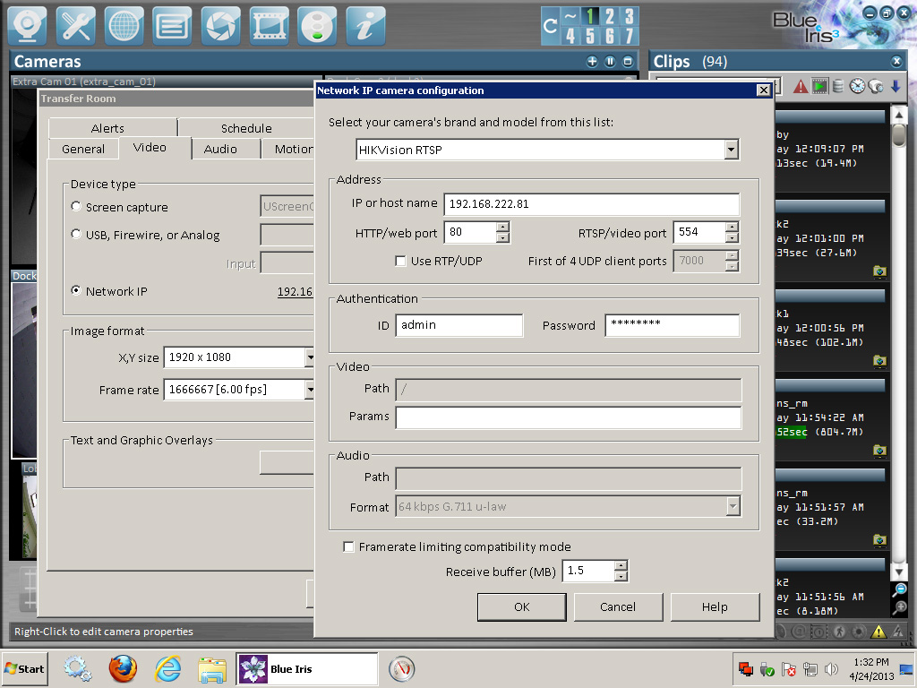

...Also will these costco cameras work with this...i know the verdict is still out on if they were flashed.
Will these cameras work with what?
in blue iris for example. or would they need to be flashed and hope they work?

I have mine working with Blue Iris, no problem what-so-ever. The setup is as simple as this...
