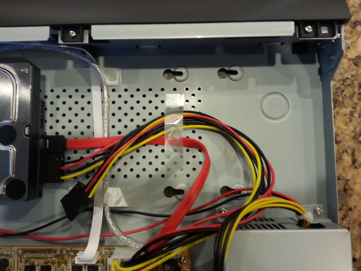

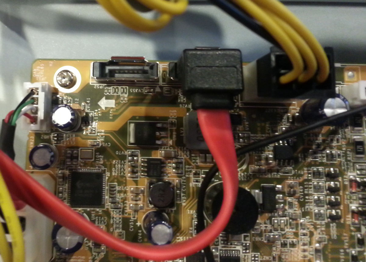

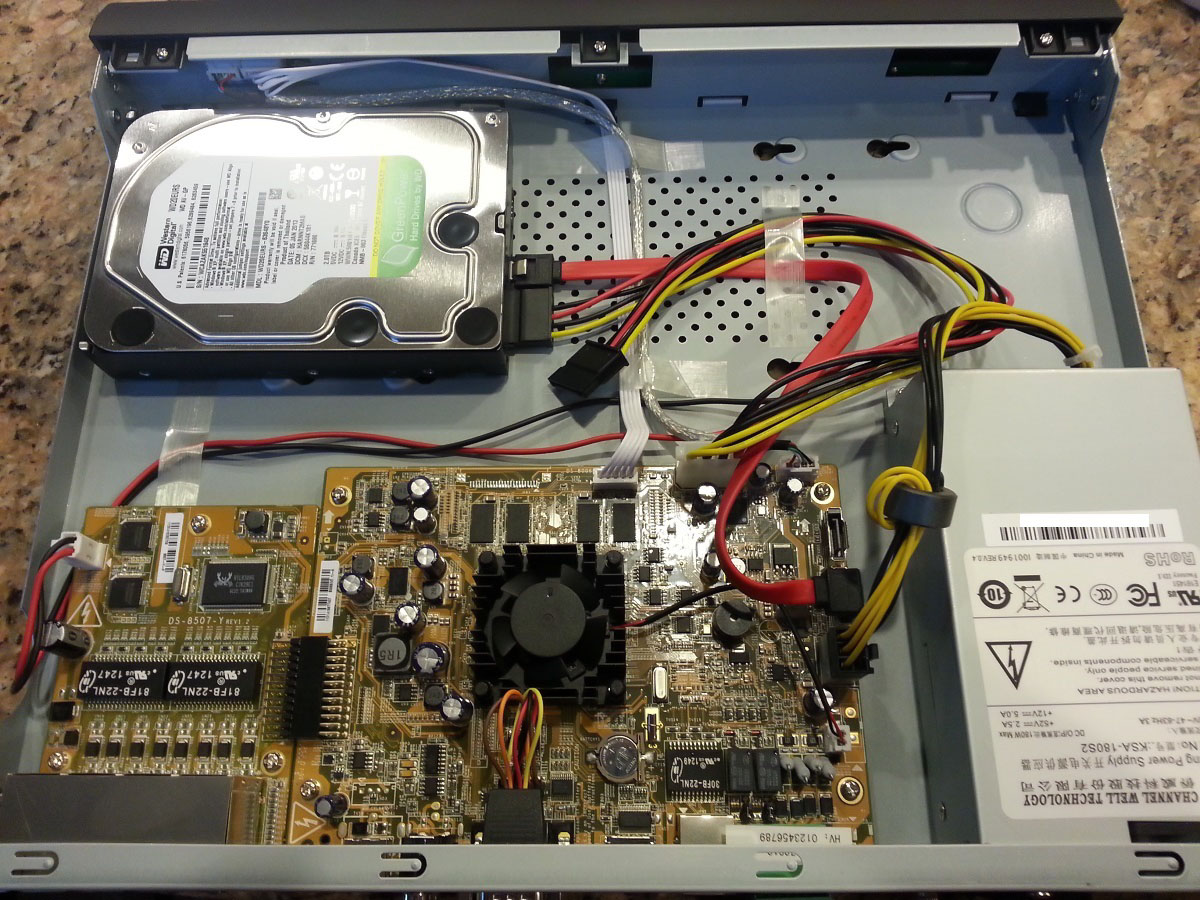

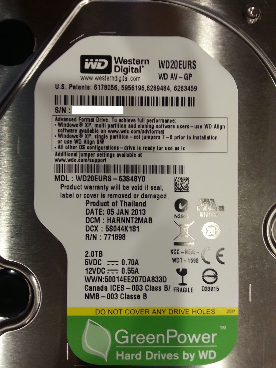

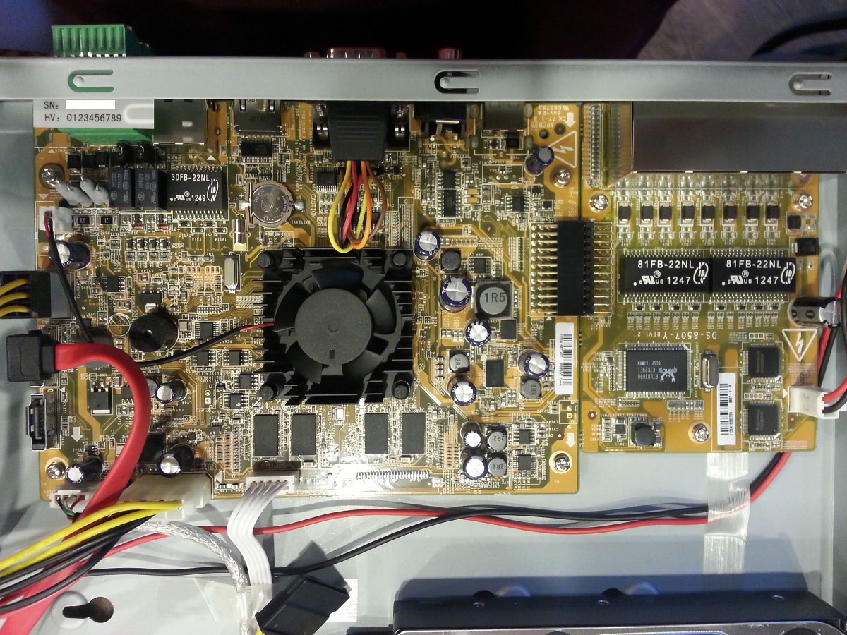

Opened it up and noticed the back panel of the NVR wasn't fully seated at the bottom. Im OCD so it was annoying me and decided since there is no warranty label on the NVR I might as well open it. Before I did open it I noticed in another box was the power cable, remote, network cable, and a SATA cable. Im like whats this for? So I was intrigued. So I opened the NVR to fix the back plate to be seated properly and to my surprise there is another spot for a 2nd HDD for expansion as well as that is what the 2nd SATA cable is for. Its already prewired for power just need to mount the 2nd HDD and put the 2nd SATA cable in there. I took some pictures of the inside for anyone else who is curious about the internals.
It definitely is not loud at all, I have a dB meter for my Home Theater system and I could put that upto it and take some pictures/videos to prove its not loud.
Need to do some more testing on this. I initially tried to hookup the camera to the NVR using a standard network cable I had sitting (like a 6ft) and the camera didn't power up or connect, it only worked when I used the 60ft network cable supplied. I hope this isn't some proprietary cable or some sort, I bought a 1000ft bulk cable of Cat5e, I was intending on running it myself around the house and fishing it through the attic, etc and just crimp on the RJ45 jacks. Maybe its just a different pinout they use instead of standard 568A/568B cable. But again need to do some more testing on that. Ive only played with it for about 30mins so far.

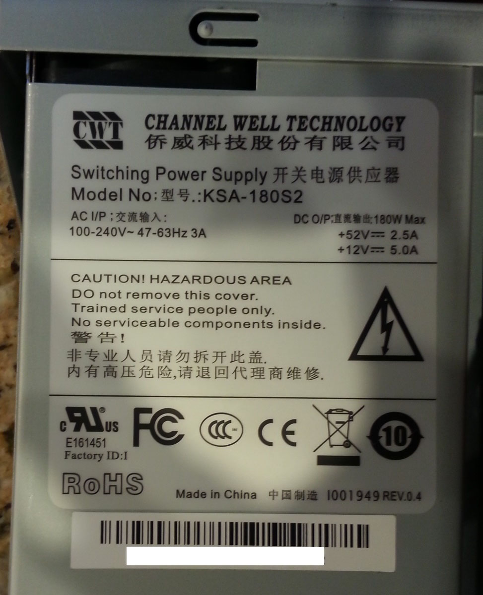

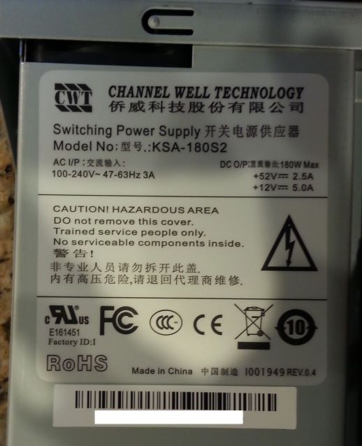

Here is the pictures of the internals and closeups of the HDD, Power Supply, Main board itself, SATA port.

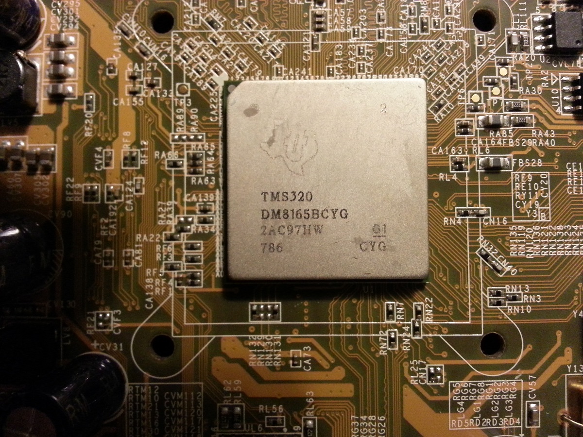

do you know what processor is on that board?
Yes, pop the fan off it and tell us what's written on the top of the processor. You may have to wipe some thermal compound away to see the markings.
Doesn't seem that easy to pop the fan off. Almost seems like its screwed in from the bottom of the the board. Those release pins didn't release the fan off the CPU.
Look for a spring clip. If none, then the thermal compound is actong like glue. Use a hair dryer to heat the fan & CPU up and then pop thay sucker off.
Don't worry about messing anything up. Rememeber it's from Cotsco. This is for the binifit of everyone. lol
Aren't those 4 screws on the corners of the fan? Looks like black plastic caps over the screws or
something.r

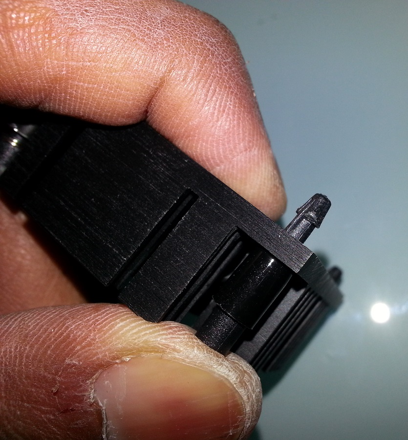

Man someone owes me for tearing this thing apart. As I suspected, this isn't your ordinary heat sink spring clip, Im familiar with those, built many computers in my day.
Ended up having to basically unplug everything off the board, unscrew the board, and from the bottom you can see these are basically one time use clips for the holes through the motherboard. So ended up having to use needle nose pliers to carefully squeeze them inwards to pop them through the hole.
The heat sink finally came off and cleaned up the TIM which was unusually hard, then took the picture below. Its a TI chip.
Here is the spring clip which you can see is only meant for one time use.
Heres the indepth details about this processor. Its an ARM Cortex A8 Core
