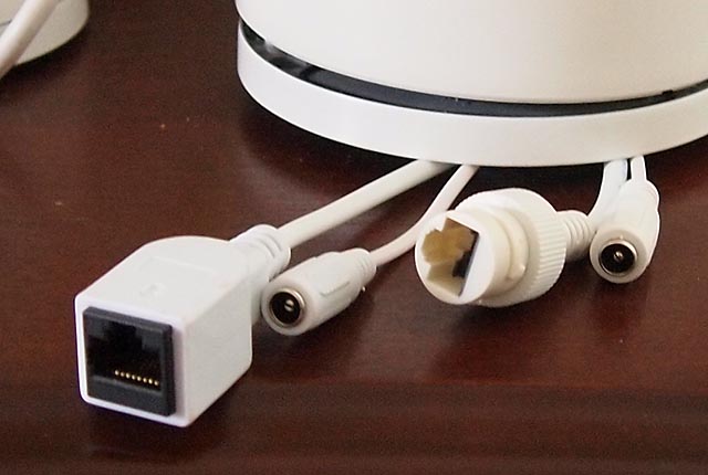

Can someone post a picture of the new RJ45 dongle (round one vs square). Thanks!

Ah perfect. I assume there is a twist lock or something on that goes over the other side? Anyone know if the 2 pack Swann from Costco are shipping this way yet?

It does come with the adapter for the Ethernet side that screws on for a weather tight seal, but you have to crimp the rj45 plug after you slip this on. The advantage is that it's much smaller than ACTi's solution, hence a smaller hole needed, but with ACTi's you can slip it over a existing cable with the plug already on it. Tradeoffs, can't say one way is better than the other.

fyi lorex does not come with the other side of the weather tight seal, i got them on my swann full size bullets, but not with lorex.
i'm guessing that lorex and swann would normally not send them out with the weather tight seals, since they are normally sold in kits with a 100ft of terminated ethernet cable.

Here's what the rest of the connector looks like. As BW says, these are for bulk cable, and have to be installed before crimping the connector.
Unassembled - the white rings are soft silicone rubber or similar. The large skinny ring seals between the two halves, and the small tall ring slips over the unterminated cable, and compresses against the loose half and the cable. It looks like it should be effective. I didn't use mine because I'm using pre-made cables.
Assembled, ready to be screwed down and connected:
