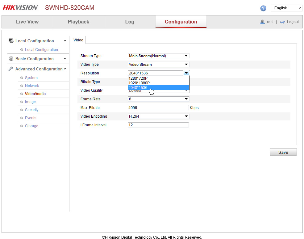

Your lucky i even found time to flash it. LOL...but alas here is the screen shots from the interface after upgrade...check it out here
http://imgur.com/a/lCi00
NOW GO FLASH AWAY

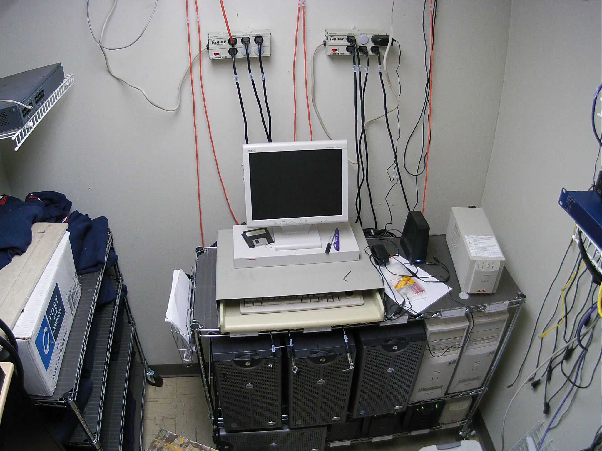

Yes, before I read your last post, I figured you were bluffing and I couldn't stand it any more. So I flashed one of my SWANHD-820CAMs with the Hikvision firmware. It appears that I have been successful. It appears that I now have a 2048 x 1536 resolution available in Configuration > Video/Audio (as shown below). I have this camera temporarily hanging is the server closet so I have no super-terrific video to share with you. Indeed, the only change in the cameras web interface is that I have now have a 2048 x 1536 resolution available and the screens all say "HIKVISION" in the upper left corner. In addition, Blue Iris appears to be receiving 2048 x 1536 video goodness. [iThink]Success![/iThink].
One more thing: a WaRnInG! Flash at your own risk and, if you do, you WILL void your warranty and/or you may brick your camera thus rendering it useless and non-returnable. You have been warned.

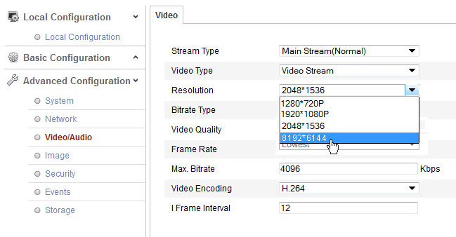

People do that? Just go on the internet and tell...LIES. Cmon man. As you can see by my pictures I wasnt bluffing!
What is this suppose to show ? A terrible photo edit ?
I've heard that there are more skeptics than liars on the internet, but I somehow doubt it...
I'm gonna keep my mouth shut lest I generate anymore animosity with my sad jokes, lame excuses, dull points and bad photoshopping.
