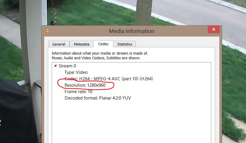

Well, that's what I was thinking when I used VLC to give me the info on the video.
Sorry STtickman, I'm a tad confused: which video did you inspect that resulted in the reported 1280x960 resolution? Was this video from a Swann SWNHD-820CAM which had been flashed with the Hikvision firmware?
