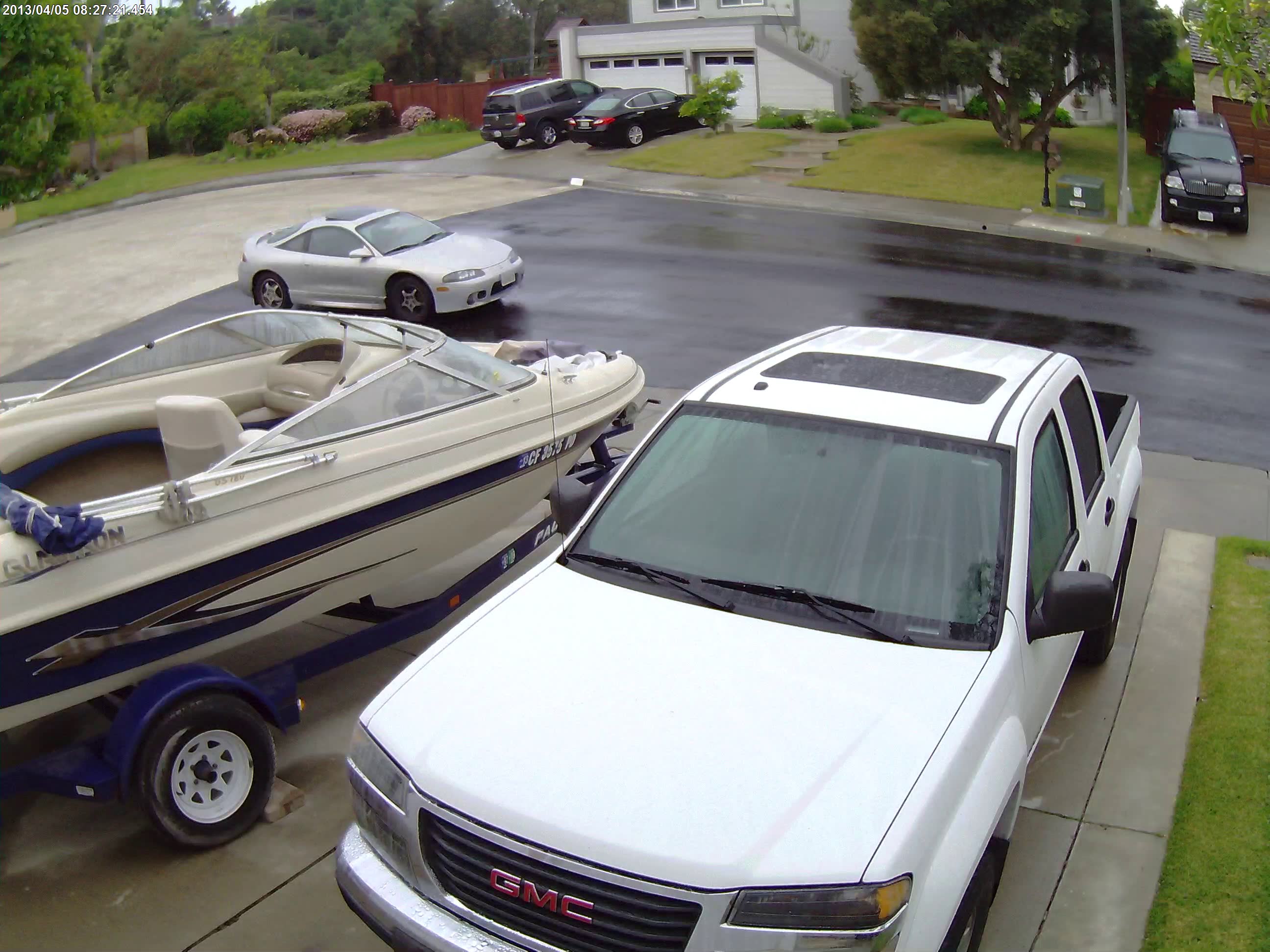

There are reviews on 5MP cameras, currently have the Axis P3367 setup but ISC West took priority but here's the ACTi E33. BTW, that image was provided to law enforcement as that silver car has been seen hanging around various streets for hours possibly casing homes with criminal intent.

I saw some more pictures of the ACTi E33 recently and while decent the real image detail and resolution are a bit disappointing to me. Especially in the background there is a lot of compression or something going on. Maybe the lens is a bit too fuzzy for that many megapixels? I know they aren't that expensive for a brand camera, but still!
Did you blur the front plate of that 2nd generation Eclipse? It's a 1995-1999 model.
Or is that just the camera itself. Just curious. Was hoping it would make out something on the plate.
No, not blurred. You think reading plates would be easy, but at that angle, it's not visible, even with the 5MP P3367-VE mounted in the same location, same focal length it looks blurred. Even the car across the street when that's there and I have a clear view of the plate in perfect lighting you can't read the plate number.
I just wonder why after the driveway everything appears to be like a water color painting.
For the price, It would almost seem better to have two Dahuas, One wide, and one longer focal length to capture those plates/details on the street.
Would I be wrong?
Having one Cam wide angle like that photo, and another with say a 12mm ( Just guessing ) lens or so to capture just the street....
I don't know why but it just seems "Lacking detail" to me. Or am I completely naive?
How much do you have to spend to get that angle, but detail in the street.
WOW! I'm actually a bit shocked a 5mp can't reproduce those numbers- especially the one parked directly across the street. The full size picture does indeed look smeared, almost like you have camera sway at that very moment. Is this a pic from a substream? Maybe water droplets from the rain. I mean, the plates looked intentionally blocked- not even a hint of an out of focus number. Something does not seem set right for a 5mp camera. I'm not expecting miracles but wow, that suprises me. My analog ptz can grab plates at those distances but I have to zoom in obviously. I always assumed HD, such as 5mp would give enough resolution to not only see plates at that type of distance, but be able to grab them on the move. Guess I was wrong! I wouldn't be surprised if that camera can yield better results than that pic indicates, be it a dome cleaning or adjusting some settings. If not, than I'm offically scaling back my MP expectations and it's now obvious- varifocals are still needed even with MP cameras.
What surprise me that u guys are surprised
On given Hor field of view we have about 70 feet
Camera capturing hor 2592 pix
so 2592 :70=~37 pix/foot
but Lic plate is under angle so u have even less pix per foot
I am not even talking general poor images coming from camera (high compression, poor lenses)
that another story
Point is simple
we need about 70-75 and more pix/foot for Lic plates
I understand it's not going to be a $5k camera or hell, even a $2k camera. It's a $400, and for $400 I'll take it over any $400 analog with the same Field Of View.
I don't know why but it just seems like theres an issue with the camera or
something. Your Boats ID number on the back is even smeared like the "water Color Image Look"
and that's pretty close....
Out of all the 5MP or 3MP cams you've tested, is this right on par with IQ expected?
Just curious, I wouldn't deter from ip mp just because of this. There's no sub for pixels/res

Sorry but that first snapshot in my humble opinion isn't good.. I can hardly make anything out with any real detail.
I mean yeah the car color and enough to figure out what model it is...
2nd pic is good, But it's a ptz. We can't compare a PTZ (even analog) to a ip mp that has a wide angle lens with a fov over 70-100ft.
Not trying to step on any toes, Just can't compare ptz's vs fixed wide fov cams. Analog or mp ip.

I didn't say YOU said dahua is garbage. And the reason there isn't any car detail in the wide shot is because, well, cars aren't really showing much! I guess what it comes down to is, you can't just throw away basic principles just because it's an MP camera. It doesn't automatically equal excellence just because it's MP and more and more, the examples in this thread bare that out. Resolution will be greater, yes. But varifocals are still important for the proper fov, or at least the proper lens. IR or not is still very important to consider as well. You can't just throw away everything that applies to the best picture for ID just because it's an MP camera. That's what I see is gonna happen with the boxed packages if people aren't careful. They'll spend a lot more money filling out an eight channel system and besides the cameras having better resolution, they won't be much better off than a well installed analog system. And the hard drive too- you'll have only a week of storage or maybe even just days if you don't consider how much backup time you really want.

You guys are so funny, oh no, I can't see a plate 70' away with a 5MP camera, haha. So you blame it on the camera, of course it can't do it, it's a $350 camera, so that's the reason. So here's a $1,319 camera from Axis, 5MP, same "watercolor effect", same can't read a license plate head on at 70' (no, I did not retouch the photo, did not blur anyone's plates). Better low light sensitivity, better camera overall, but heck, it better be for 4x the price. Do you really want me to show you what a 3MP top of the line Dahua can do because it's not even in the same league as ACTi or Axis, but I have those images to.
