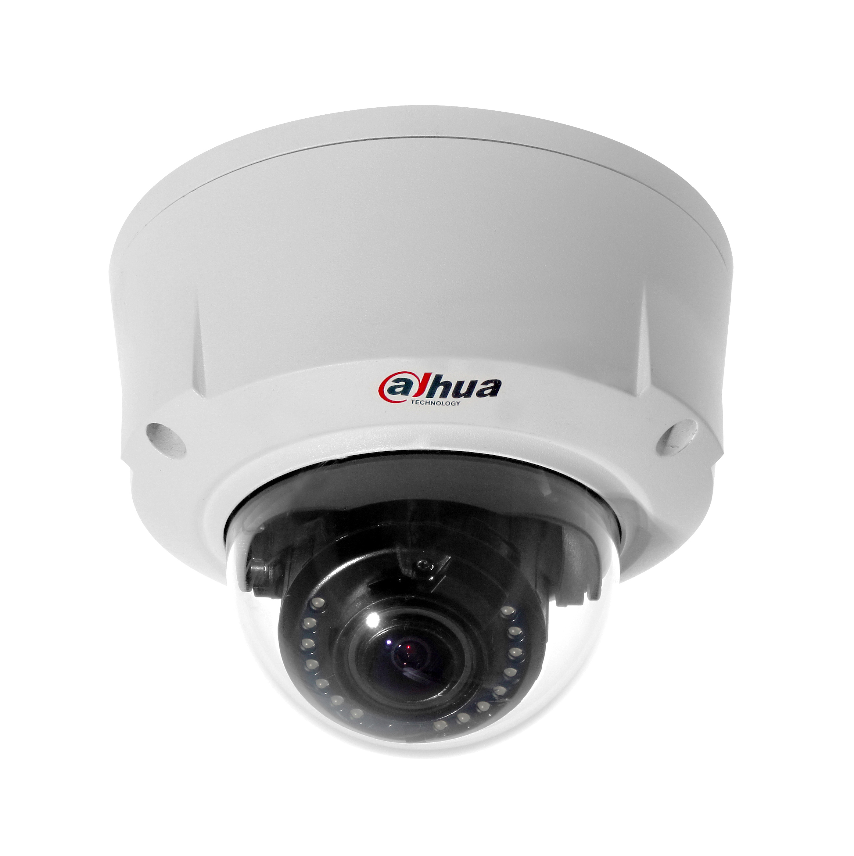

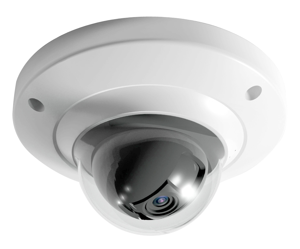

This is a 130 dollar 1.3mp Dahua mini dome. Thats right, it cost me the same and even less than most analog cameras!
Right click it and click view image.

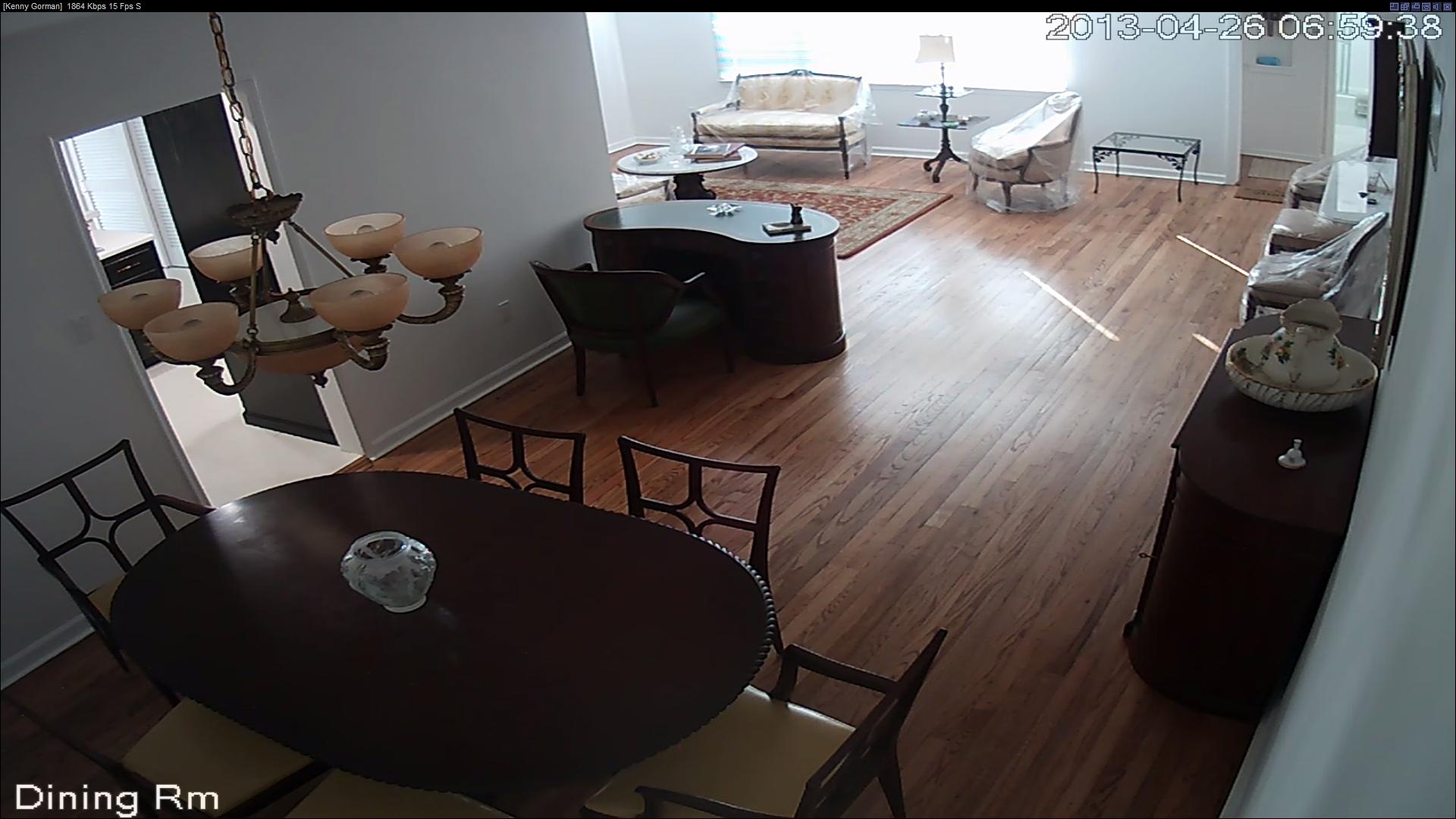

I just use the same video. When i want to know what it would look like at night i just shut off the lights in the room and it repay.
